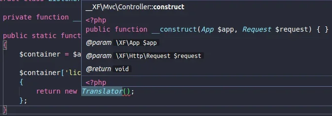

Following the example from Chris, I'm getting error in return new YourHelperClass();
It's expecting 2 argument but found zero. Is this related to $app and $request?
I'm newbie, can't find these in my class. Does anyone know what should I write there?

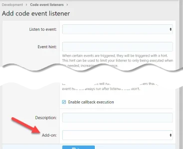

Double check your code event listener - if you don't select your addon, it will work in dev, but it won't be included when you package up the addon and deploy it to production:
I checked again the listener and it's correctly configured.
Is it due to call in the same add-on I'm trying to uninstall? Any other suggestion?
