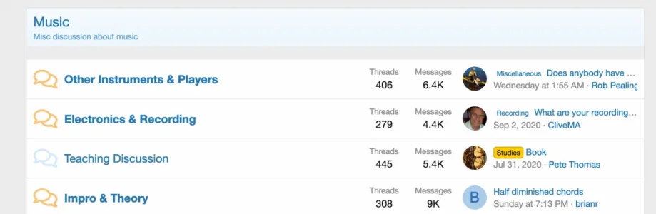

But on my forum that just increases the white space bnelow, not adding the gap showing page background.
Editing the template took the heading out of the container.
But again, as long is it works for you that's great!

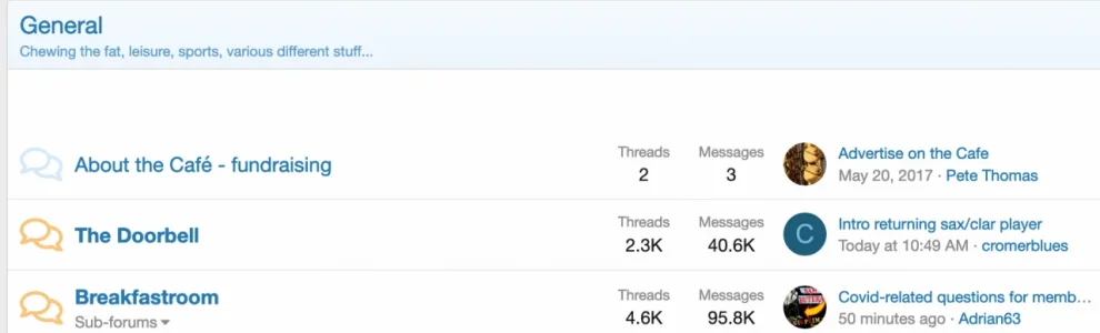

You're right. I didn't find the extra white space until now. The template modification does the trick. Thanks.
But the category block can't extend fully to the page width on mobile view now. There are gaps on both ends. The forum blocks are fine.

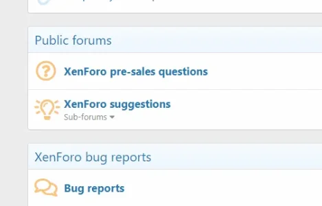

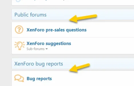

I just thought of a much simpler way to almost get what you want. Only needs a small bit of css in extra.less
This keeps the block header within the container, and just adds a border bottom same colour as page background. It achieves the same except it still has the container L/R borders. I actually prefer this look.
h2.block-header
border-bottom: 20px solid @xf-pageBg;
For this code, there'll be a grey block between the category and forum block. I made it 5px and it really looks good though it's not really something I was looking for. And for this code, no change in template is need which is good.
Well you can make the colour whatever you want, eithyer match the page background to look like a gap or different colour as a bottom border. I like this also.
