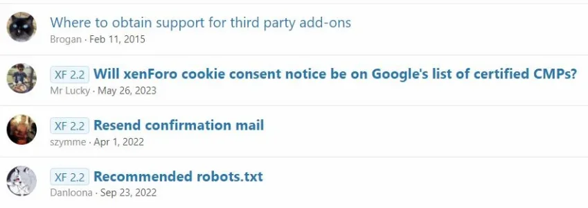

XF 2.2 How should I remove this setting for bold in unread threads?
Are you talking about within the nodes themselves or at the main category listing page?
For the category/node itself you can use this in extra.less template
.is-unread .structItem-title {
font-weight:400;
and that should (on the default style) use the same weight as the normal read ones do.
For the main category listing
.node--unread .node-title {
    font-weight: 400;
should do the same thing.
It will make it hard for your users to figure out what posts are new and what ones aren't easily unless you do something else.

thank you very much
