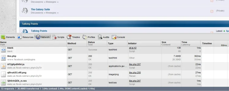

MagnusB
76 requests ❘ 1.40MB transferred ❘ 12.07s (onload: 11.52s, DOMContentLoaded: 1.32s)
The thing slowing me down was twitter:
jot
r.twimg.com
GET
200
OK
image/gif
tweet_button.1337330192.html:1
Script
402B
43B
9.73s
9.73
When images is cached I get:
75 requests ❘ 121.45KB transferred ❘ 1.89s (onload: 1.56s, DOMContentLoaded: 1.06s)
That is with a 25/25 fiber connection.

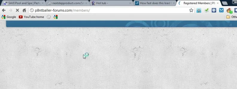

Digital Doctor
I felt it was reasonable ... but the page blanking seemed to make it feel longer.
When using Xenforo.com the Tabs don't reload when I click Members. But they do on your site.
The blanking is what I didn't like.

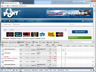

Floren
12.25 seconds to load that page first time, through a 10Mbit connection in Montreal Canada.
3.23 seconds, on page reload.
I compared a setup I finished for a client with an army of forums on front page and SSL connection.
The load page is on average 1.40 seconds, very close to XenForo front page time load. His servers are located in Europe.
p4guru
Messing around with some caches and reverting my.cnf back to default.
Can you guys let me know how quick this "feels" to load for you and how it feels to browse the site.
http://p8ntballer-forums.com/
Thankie.
11.15 seconds to load on 100Mbits connection from Australia - you have 1.4+ MB page size ! shave it down to 500KB in size and you'll improve your page load times dramatically. In comparison Floren's linked site https://www.thcfarmer.com/community/ loaded for me in 3.83 seconds and Xenforo.com front page 3.08 seconds and Xenforo forum home page 3.95 seconds

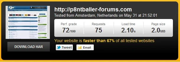

Well I have just shrunk some of the files down, the page should now be aprox 1.1mb in size.
Anyone spot anything else I could do?
DBA
Have you enabled Keep Alive? Last I checked it wasn't on.
It's still taking a 20 MB connection ~3 seconds to load.
http://www.webpagetest.org/result/120602_FQ_9AD/1/performance_optimization/
Also check to make sure that your gzip and cache are setup right.
Personally the next thing I'd do would be to start creating image spirits. For example putting those 7 ad images into an image map would eliminate 6 requests. It also looks like majority of your site icons aren't in a spirit.
