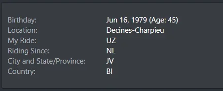

I am having daily multiple registrations by spammers and their profile always looks about the same as this
I am running the following Spam traps but nothing seems to stop these guys.
Stop Forum Spam - All setup
DNS Blacklist & Project Honey Pot - All setup
Add-ons as follows
So I am now at a loss at what more I can do other than manual approve every new member.
