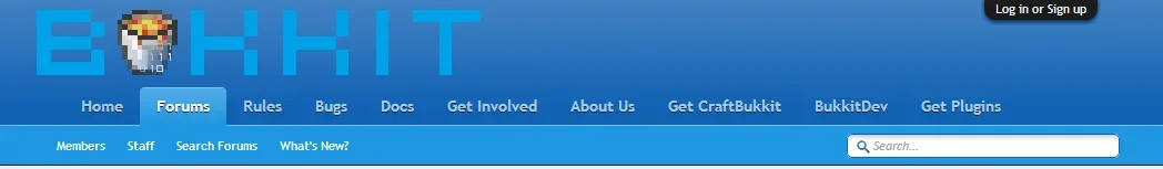

Hey I really need help with something. I got an addon that displays the staff members on a custom page on the website. It is normally set as a navigation tab, yet I would like to make it a Sub-Navigation tab under the Forums tab. I don't know how to do this, but I know it is possible. This example is with the exact addon and tab I am trying to do it with:

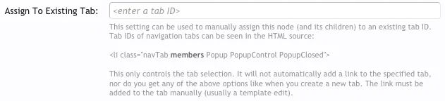

Then assign that link-forum to an existing tab id (in your case it would be forums) as shown here:
http://xenforo.com/community/resources/nodes-as-tabs.9/update?update=1441
The link-forum itself would be hidden from the node list. You are just using it to manipulate tab assignments. It's a little indirect but it works. The alternative is to create a separate addon specifically for this purpose, or modify the route file for that page similar to this:

Can you please be a bit clearer? How am I supposed to assign it to a tab? Also, how do I create the link forum? Will this give me the same result as the picture? You answered none of my questions.
