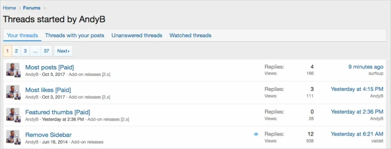

I'm updating my History add-on from XF1. What I would like to do is be able to click a link called History and rather then showing "Your threads" as seen here:
I would like to show threads most recently viewed by the member.
I have successfully extended the FindThreads class and I can view the same page using my function.

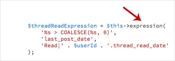

Looking at the XenForo code I'm trying to figure out the above post question. I ran across this code and I'm not understanding where "expression" is defined:
What the purpose of "expression" and where is it defined?
Thank you.
when I include the code in the previous post, I get the following error:
An exception occurred: [Error] Call to undefined method XF\Pub\App::expression() in src/addons/Andy/History/XF/Pub/Controller/FindThreads.php on line 24
