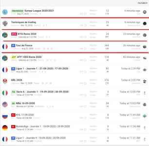

Hello,
How do I add a gap between threads?
In fact, I don't use nodes but latest messages instead.
The goal is adding a gap between threads.
I spent a few hours for trying to find the class but without success. :/
Thx for your help.

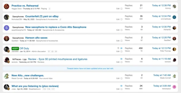

I'm not sure exactly what you mean but try adding this to your style's extra.less template:
.structItem
{margin-bottom:10px}
If you want an actual gap, as in the page background is visible between posts then the easiest workaround is to add a border the same color
.structItem
{border-bottom:10px solid @xf-pageBg}
(or whatever background you have)
