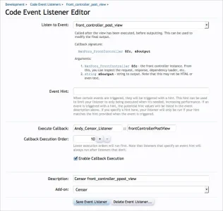

2) front_controller_post_view
Modify the global output wrapping this modification between a conditional that will check if the response type is a html one (not a json or anything else)
PHP:
if(self::$_responseType == 'html')
//Change output
P.S : be sure your "censor" replacement doesn't modify any html tags if you don't want your page to be broken.

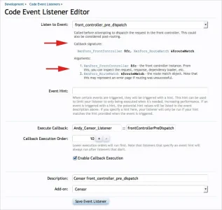

The listeners arguments are still missing. Check the example I gave you and read the XenForo listener explanations with their signatures.

PHP:
frontControllerPreDispatch()
=> where are the function arguments ? :rolleyes: Same thing for the one below. You should code less and take a nap ;)
Example:
Wrong:
PHP:
public static function frontControllerPreDispatch()
Correct:
PHP:
public static function frontControllerPreDispatch(XenForo_FrontController $fc, XenForo_RouteMatch &$routeMatch)
Exactly the information I needed, thank you cclaerhout.

My current Listener.php file:
PHP:
<?php
class Andy_Censor_Listener
	protected static $_responseType = NULL;
 		self::$_responseType = $routeMatch->getResponseType();
	public static function frontControllerPostView($fc, &$output)
		if (self::$_responseType == 'html')
			$userId = XenForo_Visitor::getUserId();
			if ($userId == 0)
				//Change output
I've tried several variables in place of "//Change output" but not able to find the correct one which would be the post message.
Look at the signature, the output variable is passed by reference. So just modify it, you should see the modifications.
And be sure what you want to search/replace is enough specific to avoid to modify any important code source.
