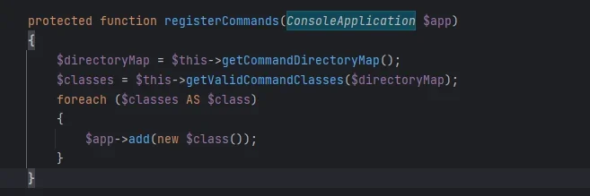

XF\Cli\Runner
To implement, use the class
XF\Cli\Command\Rebuild\AbstractRebuildCommand
in the getRebuildName method it will take the name
Just extend Symfony\Component\Console\Command\Command. Command is available directly after.

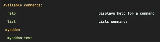

Here's what I did in the past:
PHP:
<?php
namespace MyAddon\Cli\Command;
use Symfony\Component\Console\Command\Command;
use Symfony\Component\Console\Helper\QuestionHelper;
use Symfony\Component\Console\Input\InputArgument;
use Symfony\Component\Console\Input\InputInterface;
use Symfony\Component\Console\Output\OutputInterface;
use Symfony\Component\Console\Question\ConfirmationQuestion;
class Test extends Command
    protected function configure()
        $this->setName('myaddon:test');
    protected function execute(InputInterface $input, OutputInterface $output)
        /** @var QuestionHelper $helper */
        $helper = $this->getHelper('question');
        $question = new ConfirmationQuestion('<question> Please confirm that you want to run a test: (y/n)</question>');
        $response = $helper->ask($input, $output, $question);
        if (!$response)
            return 1;
        // your code goes here
        return 0;
Yeah I just realized I had the namespace missing 🤦‍♂️ Hopefully this helps someone doing the same thing in the future 😅
Something to be aware of; when the configure is called there isn't actually an \XF::app() setup yet. Which means add-on options are unavailable when dumping the commands and command arguments.
When copying and pasting an existing command in PhpStorm, I've found it mangles the namespace - has caused me a lot of frustration in recent times when I've been trying to work out why my commands are not showing up. Having the correct namespace is critical!
