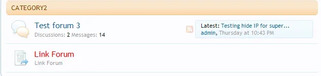

Here is a screenshot with the end result.

This will color the link titles forums in red. You can change the color to whatever color you want at this part:
<span style="color:red;">{$link.title}</span>
