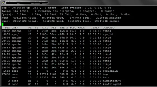

And how does your server do during the import? Where is the bottleneck? CPU? Disks?

The dropped packets (mostly affect page requests) and it's due to some sort of incompatibility of the modem/router with the ISP. I'm in the process of getting a much better one which should address those concerns.
Regarding the process itself, I don't think there is a bottle neck :S Not sure how I would know. Server load is low <1, I have a Q6600 and the server has to SAS 36Gb in Raid1

NoIF - I'm not an expert on servers but it looks to me like you server is not working hard at all. 85% idle, not waiting on hardware...
That's what is bugging me, so many resources sitting idly...
Not really about whether it runs low or not though... more that the resources are there for the peaks, and with over 2 million posts and 400k of users... peaks would suffice often for the solution you have, otherwise you would endup constantly locking up under a little load.
