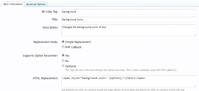

I am trying to find a way to just add highlighting (I guess another term is BG?) to BB Codes. I have visited this thread, and I tried to follow the directions, and I can't make it work, and don't know what I am doing wrong.
I have also been to the Custom BB Code Manager and just feel that is too much for me because all I really want to add is a Highlight Text BB Code.
Am I just whistling Dixie?
Can this simple thing be done in the Custom BB Code > Add New Custom BB Code

If there is no option it's [BG].
If there is an option it's [BG=colour].
What you are doing -- [BG=] -- is a combination of the two but incorrect.

Why don't you want to enter the color code after the equal sign? I believe it will work with any legal html color code.
Where you enter [BG=] it should be [BG=yellow]. This not in the definition of the BB code, but in the usage in your post.

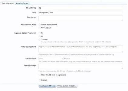

I think you may still have the made up class definition in your BBcode definition also. If that class is not in the template, the substitution will not occur, will it?
Which = sign ?
I really have no idea :) I have this where it say html replacement: (whatever that is)
<span class=funbbcodebg” style=“background-color: {option}”>{text}</span>
What do I have to do to have just a simple yellow background?
<span class="funbbcodebg">{text}</span>

But that makes it style dependent (will only work in the styles you add the CSS to the EXTRA.css).
So
HTML Replacement
<span class="funbbcodebg" style="background-color: yellow; padding: 1px 2px;">{text}</span>
The above requires no EXTRA.css.
Also, it seems you are using a reversed quotation mark which will not parse.
Correct: "
