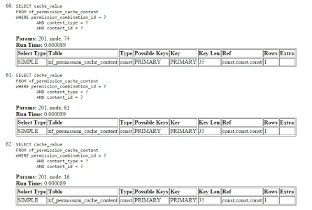

It appears that I'm now making 1 query per node on forum_list.
Any idea what might cause something like this?
We haven't really changed anything lately except for our style. The XFMG blocks are only adding a few queries although that was the first thing we disabled.
There are 67 queries that looks like this (only the node ID changes):

Are you by chance running with Debug on? It reports higher than what it actually is from what I remember if you have Debug on (and least that's what all the defenders of the high count claimed it did).
Thanks Tracy.
No. I keep debug off unless I'm specially needing it on.
I had actually enabled debug mode to remove the annoying code listener that comes back during every tapatalk update when I saw the high query stat.
With debug on I get the above high queries with XenTag enabled and fairly normal with XenTag disabled.
Edit: I've also seen other reports (after narrowing this down) in the XenTag thread that mention queries on forum_list of up to 290ish but haven't read any solutions.
That's been the general consensus. You will see a high count with debug enabled, but in everyday use (where debug should not be on) it's lower. I didn't use the add-on so I can't tell you for sure, but you can monitor the queries with it off if you haven't already.
