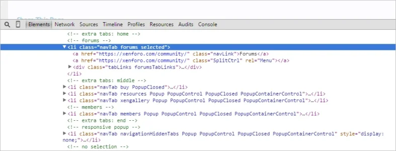

Mr Lucky Well-known member Nov 14, 2014 #1 In layman's terms if possible please... How do I find out the tab ID? can someone explain Controller Cations please? What is View Class Many thanks
P Paul B XenForo moderator Staff member Nov 14, 2014 #2 The controller and view class are from the PHP, so you would need to access to code to check. The navigation tab name can be determined by using a browser inspection tool. Forums is, unsurprisingly, 'forums'. Upvote 0 Downvote
Mr Lucky Well-known member Nov 14, 2014 #3 Brogan said: The navigation tab name can be determined by using a browser inspection tool. Click to expand... Many thanks, it was the media tab I was after: xengallery Upvote 0 Downvote
