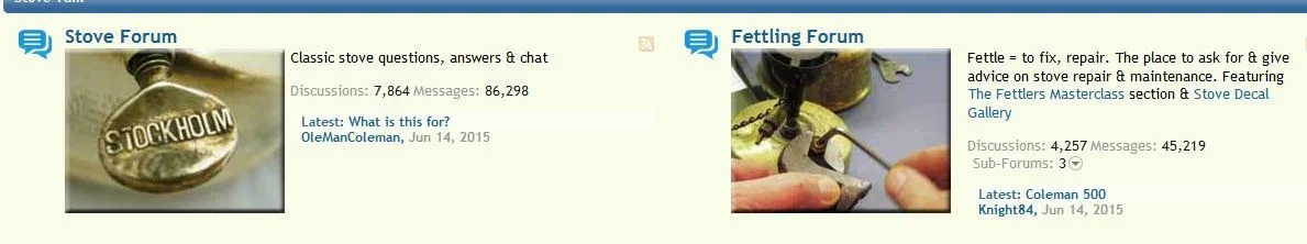

I feature an image & paragraph of text for each of my primary nodes. I'm also using the [rellect] Nodes Grid addon. The question relates to general html coding rather than this add-on specifically as same could happen without it if the image was big enough
Looks great (IMO) on a monitor & also on a smart phones where the images disappear - also tidy.
Normal monitor view:
However on a tablet the text starts to wrap & it doesn't look good:
I can force it via the ACP to drop the images for tablets but I'd prefer them to stay. Is there any way of coding the html so that if it needs to wrap, ALL words wrap?

The problem I have is if the image shrinks responsively the text still wraps - even more so. I'd like the images to stay the same size for tablet but I'm wanting the full description to stay to the right of the image until the screen get down to a certain size & then for the whole description to drop below the image. The images disappearing altogether at even smaller size eg phone is fine
