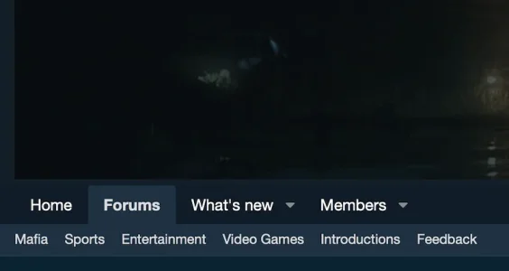

I have created a new forum and now trying to setup a homepage. Currently if I click on Home, it takes me to the forum tab.

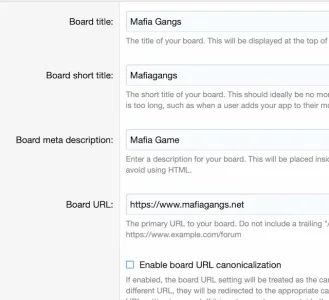

Here is my board option setup:

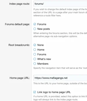

So what exactly I need to do in order to point the site to that home tab?
Secondly, what is the way to get rid of the /index.php in the URL?
I would like to have a home page featuring some widgets
Forums would be separately accessible through the forums tab on nav
Something you might find useful if you're need a 'plug & play' solution....
1. Create a page node.
2. Populate it with the widgets and content you want.
3. Set the Index page route to the page node.
4. Change the Home page URL to the page node.

Brogan's answer above is the manual method. Create a 'page' node, manually add in the widgets, and then set the node page as your home page. If you want the widget in the sidebar then it'd be <xf:widget key="widget_key" position="sidebar" />. To get the widget_key value you can either add a new widget, provide the key value, and then use it on your page or look at any of the existing widgets to view the key value.
