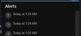

If you're trying to prevent that trigger from occurring, you have two options:
How can this also be done for the Upload of posts ? If I extend DBTech\Credits\EventTrigger\Upload the alert message are no longer visible.
Thanks for helping
Edit: Maybe I extend in the wrong way ? The same happened for the XFRM Update above.
