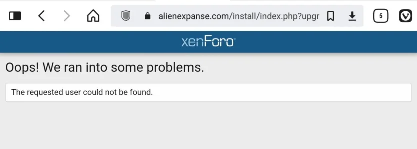

I'm having a big problem upgrading to 2.2 from 1.5...I uploaded all the install files and opened up the install page on my site and logged in as prompted however I get a message saying my user account cannot be found? What happened to my user accounts?
This upgrade has killed my forum all my accounts are gone I can't even log into my site anymore, I can't even revert back to where it was...All I have now is a database that I cannot use on anything because I have no forum now because of this upgrade...Wasted 6 years...
That's why it's recommended to back up your database before upgrading, especially for major upgrades like XF 1 to XF 2.
Did you make sure to download the upgrade files instead of the installation files? If it's the latter, you delete everything for a fresh install.
I did backup my database however my database is not the problem its the upgrade software I've been dealing with this since 5:00 a.m. over 12 hours now...
