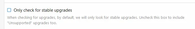

There's an announced release of Beta 5, but no one-click feature working?

That will be down to this:
You'll just have to upload the files manually in the traditional way for now.
