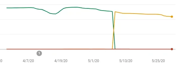

my mobile score is pathetic.
worse, my desktop urls all went from intermediate to poor right during the algo switch, so clearly, these elements ARE a critical part of rankings.
The number of urls keeps going down. They are indexing less and less for no reason.
CLS < .1 is a new target that must be addressed in the core forum. This thread scores a 0 (perfect) before this post. my site has 0 urls meeting this, which doesn't make sense. My theme is basically stock with color changes.

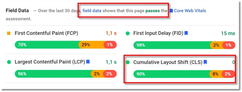

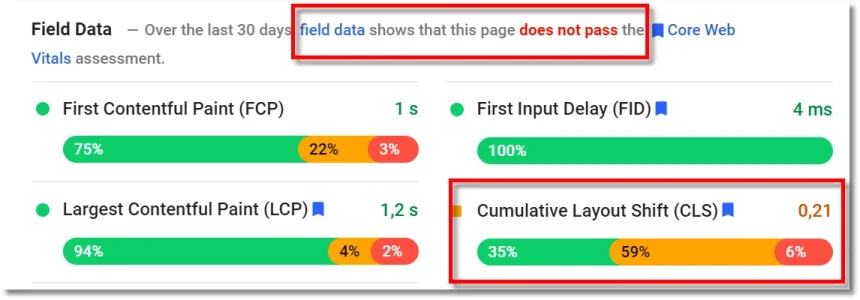

I'm trying to figure out why the CLS score is not good. Although it may or may not impact search results, I want to know why this value is too high. Apparently, large parts of the content are shifted during the page request. However, it is not visual for my.
I tried this with default layout, no ads and notification turned off. There is a big difference between desktop and mobile. CLS is ok for the mobile view.

Ah found it.
If you add a custom logo, there is no way to add proper dimensions in the control panel.
This is causing the shift.. this should be optimized in XF I guess:
Once I revert this to the original logo, the CLS score is 0!
