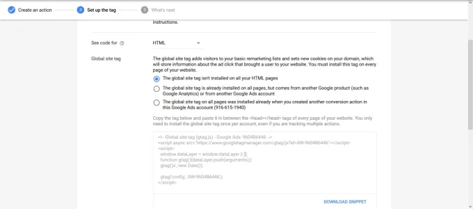

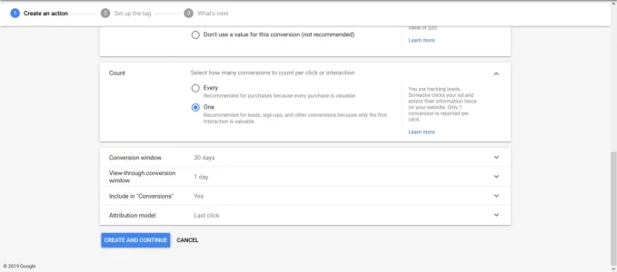

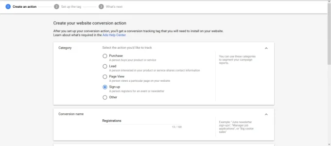

I have an add running 24/7 for my forums on Google Ads but I cannot for the life of me figure out how to track conversations, in this case being account registrations from ad clicks. I'm logged into my Ads account in the Tools > Conversions section. See attached.
Then I choose "install the tag yourself" option after that. See attached.
Where does this go for Xenforo registrations specifically? Should it be "page load" or "snippet" option?

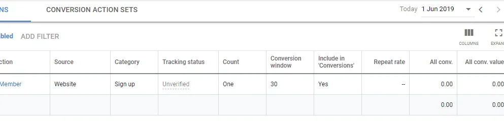

Yes, I did but nothing is getting tracked despite new registrations. I get over 300+ visits a day from Google Ads, there's no way no one is not registering from there. I'm baffled.

You need to put the global site tag code between the head tags. This is the global code, it doesn't track anything.
Try to put it in the template PAGE_CONTAINER between the HEAD tags.

Hi Guys I followed the steps mentioned above but Google says the tracking status as 'unverified'.
203673
In PAGE_CONTAINER, I added 'Global Site Tag'
and in Register_Complete I added 'Event Snippet Code'.
Also I have 'Paid Registrations' by @AddonFlare Installed on my forum. Do I need to add the above codes in some other template page ?
