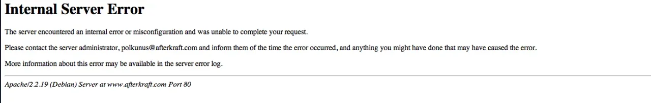

Hello,
I recently switched from having XF in my server root IP/xenforo to one of my virtual web servers: IP/www.afterkraft.com/htdocs/afterboards .
Whenever I directly go to www.afterkraft.com/afterboards apache spits out an error:
I put an index.html file in the root directory of the website IP/www.afterkraft.com/htdocs/index.html and it seems to work fine.

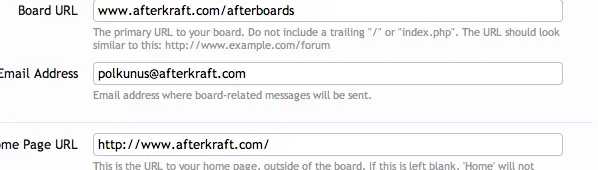

I have already changed the board information at:

Keep in mind that the website works completely fine through IP/www.afterkraft.com/htdocs/afterboards , but not www.afterkraft.com/afterboards
What's going on here? Is there anything I did wrong? Any help would be much appreciated.

If you can access ACP - have you checked XF's error logs?
Also check the Apache error_log file to see if there is any more info on the 500 error?

An internal server error is generic and can mean many things. Ideally the server log will have more information about the error.
Some things to try:
1) Remove your .htaccess file.
2) Check your file/folder permissions on the server.
3) Make sure PHP works by uploading a phpinfo file.

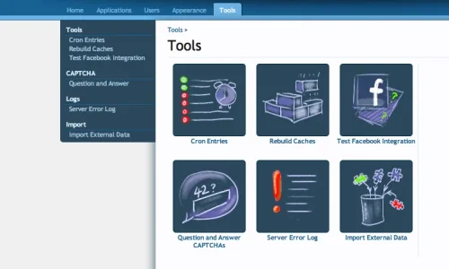

Since you can access the Admin CP, try disabling your addons, and run a file check:
Admin CP -> Tools -> File Health Check

I can't seem to find this button... Where is it exactly?
I'm able to access the entire site and all the features work perfectly fine. I'm just having trouble accessing it the way I'd like it to be accessed. Via www.afterkraft.com/afterboards. Going through my directories and manually connecting via web browser on [www/var(Basically my IP)]/www.afterkraft.com/htdocs/afterboards works totally fine. The apache virtual servers are set up absolutely fine, its just Xenforo is having trouble running under the "www.afterkraft.com/afterboards" URL for some reason

Regarding the file check... what version of XenForo are you using? That feature was added in 1.0.3.
