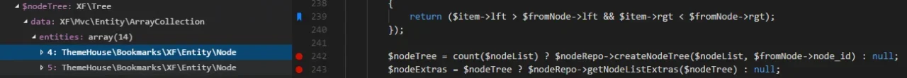

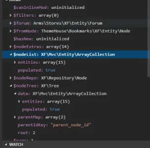

Almost @Chris D ,
That only gives the children. Node 2 isn't showing:
also tried;
PHP:
return ($item->lft >= $fromNode->lft && $item->rgt <= $fromNode->rgt);
Tried <= and >= earlier.
nodeTree picks up node 2.
PHP:
$nodeExtras = $nodeTree ? $nodeRepo->getNodeListExtras($nodeTree) : null;
nodeExtras doesn't pick it up.

It was driving me nuts as $nodeTree was right but $nodeExtras wasn't. It didn't click that getNodeListExtras looked at children only.
