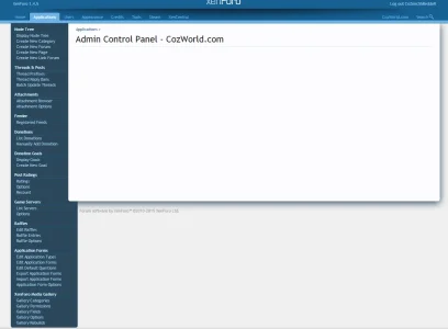

Getting blank pages in Administration Links for Gallery
CoZmicShReddeR
I am sure it's something goofy on my end just haven't been able to figure it out... I have re installed it several times... I have galleys on the front end but all links in Administration panel are blank pages..
Any suggestions or help is most appreciated!
Thanks!
