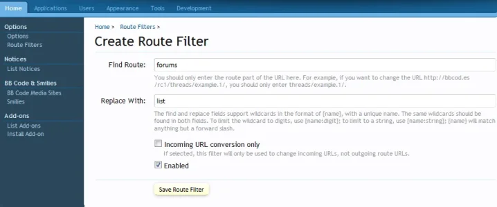

Per this example:
Turn
http://nbadimensions.net/forums/forums/nba-forum.2/
into
http://nbadimensions.net/forums/list/nba-forum.2/

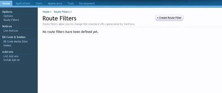

Home -> Route Filters -> Create new Route filter
Find Route: forums
Replace With: list
