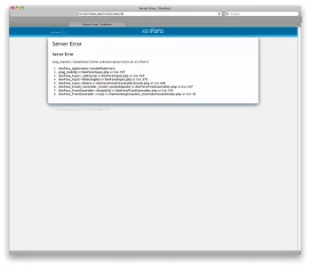

I've installed XenForo on a test server successfully, but today was attempting a fresh, clean, install of XenForo v1.2.2 on the real server, with a brand new, empty, database - and after the config.php settings have been accepted, the installation fails with a 'Server Error' reported:

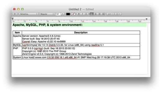

Here are the server config details, in case that is important:

The only error I can see is the one in the screen grab, ie:
Server Error
Server Error
preg_match(): Compilation failed: unknown option bit(s) set at offset 0
XenForo_Application::handlePhpError()
preg_match() in XenForo/Input.php at line 197
XenForo_Input::_doClean() in XenForo/Input.php at line 183
XenForo_Input->filterSingle() in XenForo/Input.php at line 375
XenForo_Input->filter() in XenForo/Install/Controller/Install.php at line 248
XenForo_Install_Controller_Install->actionStep3b() in XenForo/FrontController.php at line 337
XenForo_FrontController->dispatch() in XenForo/FrontController.php at line 134
XenForo_FrontController->run() in /home/[user]/public_html/xenf/install/index.php at line 18
Where else should I look for the elusive error information, please?
I'm stuck (and feeling frustrated with XenForo!)
