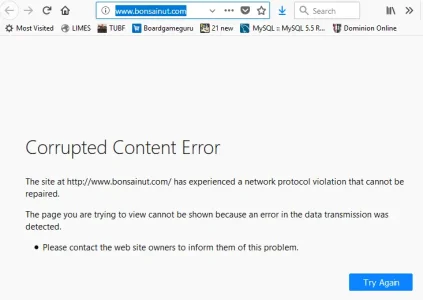

Actually it's not.
HTTP isn't forwarding to HTTPS. But non-www is forwarding to www.
Post the current content so it can be looked at again.
Change it to this..
#    SecFilterEngine Off
#    SecFilterScanPOST Off
#</IfModule>
ErrorDocument 401 default
ErrorDocument 403 default
ErrorDocument 404 default
ErrorDocument 405 default
ErrorDocument 406 default
ErrorDocument 500 default
ErrorDocument 501 default
ErrorDocument 503 default
<IfModule mod_rewrite.c>
    RewriteEngine On
        RewriteCond %{HTTPS} off
        RewriteRule ^ https://%{HTTP_HOST}%{REQUEST_URI} [L,R=301]
        RewriteCond %{HTTP_HOST} ^bonsainut.com [NC]
        RewriteRule ^(.*)$ https://www.bonsainut.com/$1 [L,R=301]
    #    If you are having problems with the rewrite rules, remove the "#" from the
    #    line that begins "RewriteBase" below. You will also have to change the path
    #    of the rewrite to reflect the path to your XenForo installation.
    #       RewriteBase /xenforo
    #    This line may be needed to enable WebDAV editing with PHP as a CGI.
    #       RewriteRule .* - [E=HTTP_AUTHORIZATION:%{HTTP:Authorization}]
        RewriteCond %{REQUEST_URI} !^/[0-9]+\..+\.cpaneldcv$
        RewriteCond %{REQUEST_URI} !^/\.well-known/pki-validation/[A-F0-9]{32}\.txt(?:\ Comodo\ DCV)?$
        RewriteCond %{REQUEST_FILENAME} -f [OR]
        RewriteCond %{REQUEST_FILENAME} -l [OR]
        RewriteCond %{REQUEST_FILENAME} -d
        RewriteRule ^.*$ - [NC,L]
        RewriteRule ^(data/|js/|styles/|install/|favicon\.ico|crossdomain\.xml|robots\.txt) - [NC,L]
        RewriteRule ^.*$ index.php [NC,L]
</IfModule>
That should fix the HTTP to HTTPS problem.
If not, I'm out of ideas. :(
