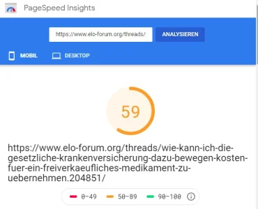

My site runs fine with googleADs. I optimized our page with the pagespeed instructions and we have at least 2 million postings ... Desktop 100 and Mobile 86 now. :D
Are you entirely sure about that? I'd be pretty amazed to see anything 80+ for mobile on a website with Google Ads.
Thats the trick ;)
For Google is important that the call of the startpage of a site is fast. The rest does't realy matter
Believe me, it does ;)
They do measure each page individually and even file reports if certain pages are slow - every page needs to be fast, not just the homepage (which, in forums, usually does not get that much traffic).
