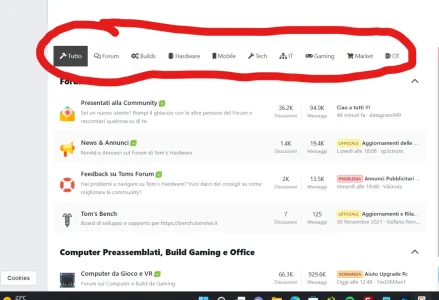

it is exactly what I was looking for, but it is absurd that it is not already integrated. Heartfelt thanks for your free resource.

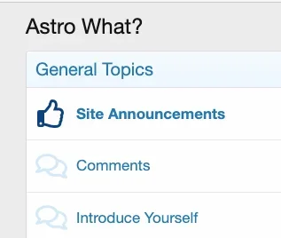

A simple little search turned up this EXTRA.less from back in 2020 using FA icons for the nodes (you can define different ones). I don't know if this still works or not, as I don't have a "test site" set up... Just tested on my default style... and the below modified example gave the image you see.
.node--idxx .node-icon i:before {
    content: "\fxxx";

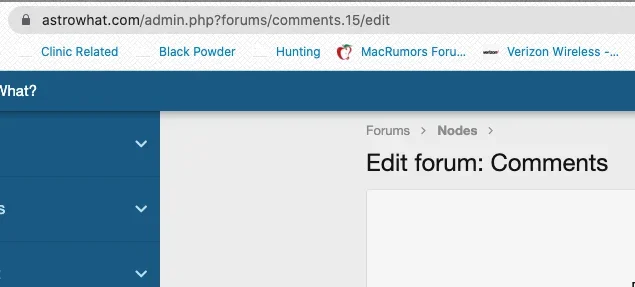

You get the node idxx by looking in your ACP and go to the Forums -> Nodes and then place your mouse over the node you want and you should see in the bottom left of your browser similar to this
notice the .14 in the URL... that node ID is 14. If your browser does not show that when hovering over it, you can always go into the node itself and you will see the Node ID in the address bar.
Screen Shot 2022-10-01 at 5.41.19 PM.png[/code]

first of all, thank you very much. your answer is great. I am a recent customer, and I currently have 2 active plugins. For the moment I choose the plugin, because it works well, I also have themehouse NODES integrated into the themehouse theme so I don't need to install the plugin mentioned above (icon forum) in the future I consider both solutions. thanks to all friends!
