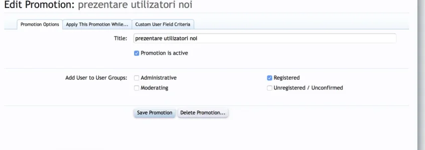

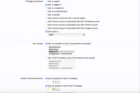

I see, can you please help me do this, i have made the promotion as following:
Screen Shot 2015-12-09 at 17.01.49.webp Screen Shot 2015-12-09 at 17.02.19.webp
Is this correct? What else must i do, sorry for being such a non-tech guy
All users should have the Registered user group as their primary user group. Therefore you shouldn't be adding users to the Registered user group in a user group promotion.
You'll need to create another user group and use that for the user group promotion. The promotion could occur when they have made 1 post. You'd need to have 1 forum set up with just one thread in it. You'd then need to revoke the ability to create new threads in all forums for the Registered group (well, maybe except for the introduction forum) but allow it for the new user group you create. You'd also need to revoke the ability to make new posts in all forums except for the one with the welcome thread in it for the Registered group and allow it for the new user group you create.
