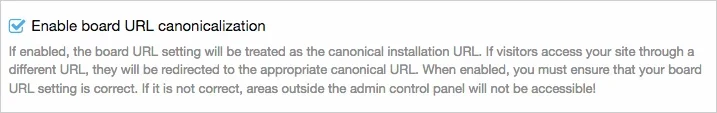

Hi I'm having the same problem. I have another forum with HTTPS perfectly running and yet this new 2.1 Xenforo installation is not working the same way.My board URL is set to HTTPS, canonical URLs are checked, I don't have custom URLs for anything in the TOS/registration, I have the rewrite in my .htaccess file, and I can access my site via HTTPS but it will not FORCE the https...
When I put the following code in my config.php file, the browser cannot find even the HTTP site:
$_SERVER['HTTPS'] = 'on';
I have done everything exactly like the other forum installation, which is Xenforo 2 -with 2.1 something is wrong.
