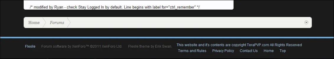

I am working on cleaning up my footer. My biggest issue is a line of text I added "This website and it's contents are copyright TeraPVP.com All Rights Reserved" should be on the exact same line as the links for Terms & Rules along with my other footer links. Somehow it shows as being about a half a row too high. Can anyone explain what causes this shift and how to fix?

You're trying to fit too much text in the space available.
This is how it appears to me:
You just need to change the template to move stuff to separate rows as there is just too much for one or two rows.

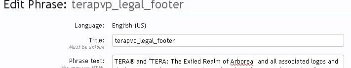

What I am trying to do is ad a length legal disclaimer for my site. I made a phrase "terapvp_legal_footer", I tested the phrase itself and it works. Now I am trying to get it to display in the footer. I am working in the footer template which seems to be the right spot. I have tried many variations but what seems to keep appearing in the footer is the simple text "terapvp_legal_footer" rather then the phrase. What I need is for the xen phrase to appear, not the text "terapvp_legal_footer".
