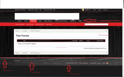

Yes, now they are in a single sprite image as per the move to CSS sprites in XenForo 1.1. What you'll have to do is edit /styles/flexiledark/xenforo/node-sprite.png and replace the icons inside that image with your own. For reference, each one is 44px wide (or rather, the image should be divided up into four 44px sections). :)
Thanks Erik.
I get the concept of what youre saying. But how we stich 4 images together? I got MS paint lol, do I need something more advanced?
Thanks Erik.
Yes, something that will handle proper transparency at least. Try paint.NET or GIMP. :)

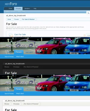

However, there appears to be an issue in both Flextiles with the ad_above_top_breadcrumb placement.
See the attached for an example...
With Flextile, it puts the ad block before the nav, when it wants to be above it - i.e. outside of the same block as the nav.
