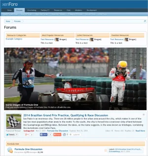

FireDaemon - Resources on ForumHome - Shows resources on ForumHome above the nodelist with 4 customizable columns

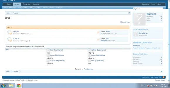

On the above image that I posted where is that 2nd line coming from? (Wicked Stangs Windshield Banner) How to remove looks cluttered..
It's a resource entry in your resource manager. You will need to delete it if you do not want it to display.
This addon simply pulls all resources from the resource manager and displays them, it doesn't let you specify which will display.
I have the same problem with Barbossa, how to solve it?

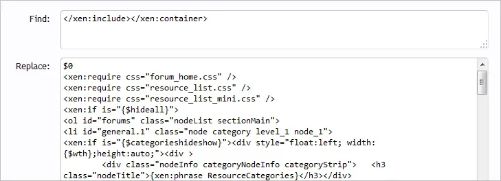

Check the status of any template modifications for this add-on and mine.
Are any of them not applying?
All are applying (green numbers beside all). Maybe is problem in execution order, but I can not change that in ACP
If they are all green then it's another issue.
I'll install this add-on on my dev site to see what the problem is.
You will have to change the TM for this add-on like so:
The find text must be changed.
Also the replace text - note that the line for the board title has been removed, as well as the $0 which has been added.
The result:
You will have to enable debug mode to change the TM.
