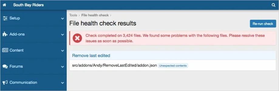

Not sure why I'm getting this error message:
The file contents look okay:

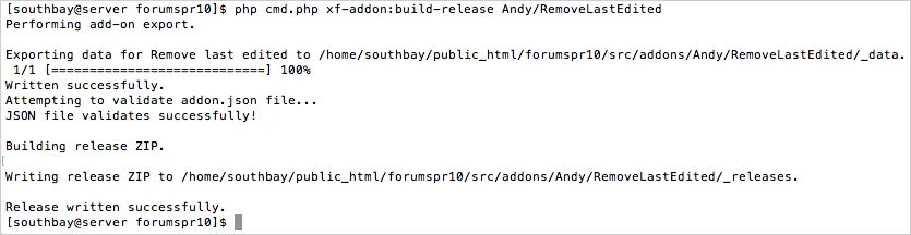

I would figure the hashes.json would be rebuilt we we do a "build-release" but apparently it's not. I say this because as you can see I can do a
build-release, but I still have the same error message as I show in post #1.
They definitely are. An explicit option needs to be passed into the build-release command to skip generating hashes.

Can you upload the addon.json and hashes.json file (or the entire add-on ZIP if possible)?
The hashes.json file is added the built release zip, it isn't in the folder when developing as you're going to be modifying files.
If that's your development board, you can just delete the hashes.json file.

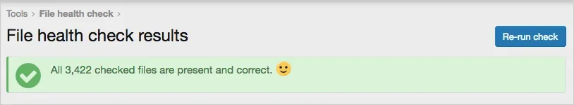

Hi Liam,
I deleted the hashes.json file and then ran the "build-release" again, but it does not recreate the hashes.json file.
I just check the Admin Control Panel and ran the File health check and I have no more errors:

The hashes.json file is created when you build a release, but it isn't saved to the existing files - it's but into the built ZIP, as there's no need for it on a development server.
When a user extracts the zip, the hashes.json file is there, and if it weren't, the install wouldn't work - XF2 requires the hashes file and the hashes to match for an add-on to be installed.
