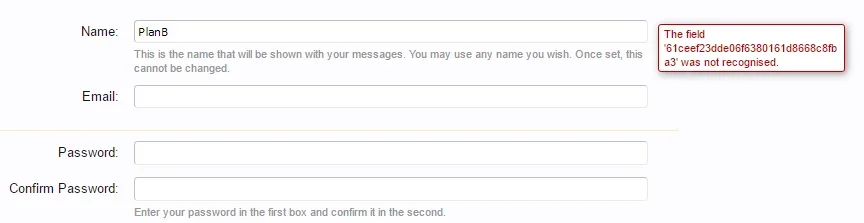

Can someone please help me troubleshoot the following? I'm getting the following error every time I test my registration...

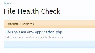

When I run a File Health check, I am seeing the following...
You will need to upload the Application.php file again, at least.
To rule out any other issues I would recommend downloading a new copy of the upgrade zip archive from your customer area and uploading all of the files again.
Once you have done that, rebuild the master data to rule out any template issues.
