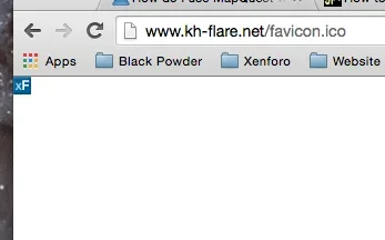

Also, make doubly sure that you don't have a rewrite of ANY type in your htaccess for the favicon.ico. When I go to your site to specifically pull it up, this is what is showing up:

Thanks to @Tracy Perry this issue has been resolved.
According to him, it was an issue with LiteSpeeds cache being "froze up" and with some brute force he managed to unclog the metaphorical drain. This area isn't my forte so I might not be explaining it right but the important thing is it's fixed now and I know what to do if the issue resurfaces.
I'd like to thank everyone for their responses and a big thanks to Tracy.
It was a caching issue... but apparently not LS since the caching module is not enabled there. Not sure if you are doing file caching or writing the templates out to file - didn't check that, but you know how to fix it now if it happens again.
