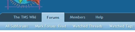

To get people to click, I added a tab called "Help:"

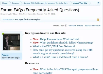

It's just a direct link to a specific forum thread called "Frequently Asked Questions." The same thread is also stickied in the "About Us" subforum. The thread is locked and is just one big post.
The tab gets clicked on a lot. In fact the thread is our most viewed thread. That may have something to do with the fact that we are a nonprofit that serves people of diverse ages who often aren't computer savvy.

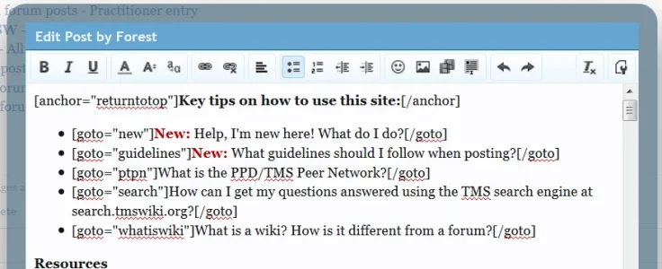

The thread itself uses a custom BBCode to create named spans (i.e. spans with id="" attributes) and a second custom BBCode to easily create links to those spans. Using these, we can create a Table of Contents or an index as well as "Back to Top" links. It may seem primitive, but people seem to really like it and I don't have to install an addon. Because it's just one big post, I can customize it to be whatever I want, so I like it, too.
The table of contents at the top looks like this:
To create the named spans, I use the following HTML replacement in the custom BBCode:
<span id="{option}">{text}</span>​
Don't laugh, but here's the HTML replacement I use to create the links to the targets:
It has a very obvious limitation, but it is dirt simple to maintain and doesn't have anything fancy that could get screwed up.
Using these two BBCodes, the BBCode associated with the above screenshot looks like this:
Pretty clean, eh? Maybe it's the programmer in me, but I really love minimalistic solutions.
