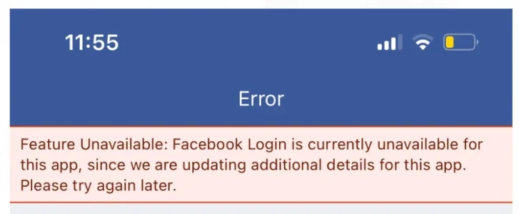

Except, when people try to register via FB. they get this error: Feature Unavailable: And have done for about three weeks.
Can anyone tell me what might be wrong?

I'm having the same issue. I think it's because they made changes that require their "advanced permissions" before the app can go live. You're able to log in just fine because you are an admin of the app, so basically its in test mode only for you. You have to request advance permissions, which I am in the process of doing now.
