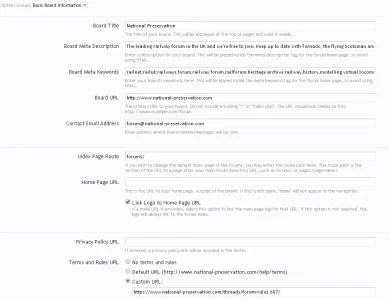

I wouldn't be surprised if it's the http vs https element -- your XF "Board URL" is http, so that is the URL that gets passed to FB. Try making those consistent.

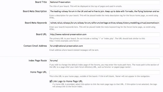

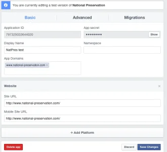

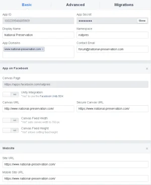

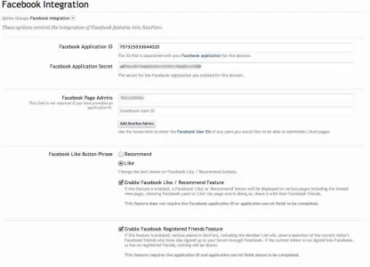

OK, im having no luck at all, I have made so many changes, and no joy...
Here is the current status of my system..
Try removing the app domain and/or mobile site URL settings. Those are the only differences I see from the apps I've created (and from the doc instructions).
Right now I have got this issue fixed, it was relating to the oAuth in the advanced settings.
