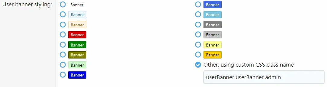

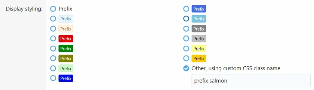

That has worked since 2014. I transferred it over and I have tried changing it many different ways depending on the threads I have read while searching, but I can't get it. I took a couple years off from doing web work so it's probably something simple. I can't find much info out there though on how to write less code or format the extra.less. Here is the screenshot of how I have the custom color called in the ACP.
If you can tell me what I am doing wrong, or link me to some resources so I can study up I would be so grateful. I am diving into 2.0 as much as I can. I just want to use the 30+ colors I coded and learn all the new things that I can.

For the user banners, I go into each user group and give the User Banner Styling custom code, in the admin part I put userBanner userBanner admin . Is that correct formatting? I used the wrapped span a long time ago so the banner would span across the user box and not be a small box.
I changed the extra.less for the admin banner to what you gave me and it worked. So do I even need
.userBanner--staff
? Or can I just call out the banners for each group? Sorry if I am being dense, I am trying to wrap my head around this so I can rewrite everything today.

I have the thread prefixes and the user banners done. I was in the groove and wanted to add some hover states to the thread prefixes. The code works great, this is what I have to do the non-hover state:
CSS:
.prefix.salmon {color: #FFFFFF; background: #FF9999; border-color: #FF8888; box-sizing: border-box; padding: 1px .35em; border: 1px solid transparent; border-radius: 4px; font-size: 80%; line-height: 1.26; text-decoration: none;}
So I inspected how xF2 handles the css for hover and tweaked my line going underneath the first to:
CSS:
a.prefix:hover .prefix.salmon {color: FFFFFF; background: #FF8888; border-color: #FF9999; box-sizing: border-box; padding: 1px .35em; border: 1px solid transparent; border-radius: 4px; font-size: 80%; line-height: 1.26; text-decoration: none;}
I can't seem to get it to create a hover effect though. Is this code correct? I am so close!

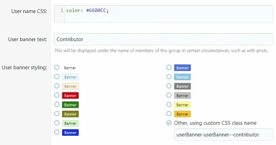

A bit late to the party (I've only just upgraded to XF2 ...) but the simplest way by far to create custom user banner and thread prefix styling is to edit the app_user_banners.less and core_labels.less files directly.
Here I have added 4 new entries to app_user_banners.less corresponding to the various user upgrades I have:
Rich (BB code):
    &.userBanner--red { .m-userBannerVariation(white, #d80000); }
    &.userBanner--green { .m-userBannerVariation(white, green); }
    &.userBanner--olive { .m-userBannerVariation(white, olive); }
    &.userBanner--lightGreen { .m-userBannerVariation(black, #ccf9c8, #bee8ba); }
    &.userBanner--blue { .m-userBannerVariation(white, #0008e3); }
    &.userBanner--royalBlue { .m-userBannerVariation(white, royalblue); }
    &.userBanner--skyBlue { .m-userBannerVariation(white, #7cc3e0); }
    &.userBanner--gray { .m-userBannerVariation(white, gray); }
    &.userBanner--silver { .m-userBannerVariation(black, silver); }
    &.userBanner--yellow { .m-userBannerVariation(black, #ffff91, #e6e687); }
    &.userBanner--orange { .m-userBannerVariation(black, #ffcb00); }
    &.userBanner--supporter { .m-userBannerVariation(white, #008800); }
    &.userBanner--contributor { .m-userBannerVariation(white, #6600CC); }
    &.userBanner--valuedMember { .m-userBannerVariation(white, #CC0000); }
    &.userBanner--premiumContributor { .m-userBannerVariation(black, #ff9900); }
Then add the custom class to the user group like so:
That way everything inherits correctly and it actually results in fewer lines of additional code.
