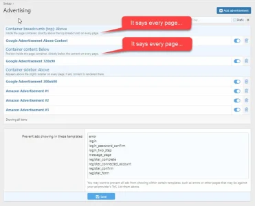

There is a Google Ad above the breadcrumb, but it doesn't display on "search results". Is that normal? How would I display ads on the New Posts results page, including a sidebar ad?

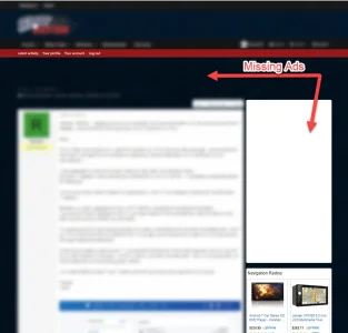

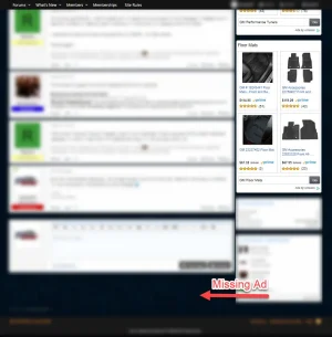

Maybe I'm not understanding what you're saying... but I see adds on EVERY page except certain areas including the New Posts and Conversations... but in those areas, the space for the ad is present, but something appears to be conflicting with the script that loads the ad code. Does that make more sense? If I have an ad displayed in below the breadcrumb, that should appear everywhere, no? Same with the footer ad? In the Conversation page, it shows the sidebar with Amazon ads working, but the Google Ad, for which the space is still visible won't load the ad code. The only time I've seen this in the past is when some script is conflicting with the ad code.

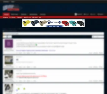

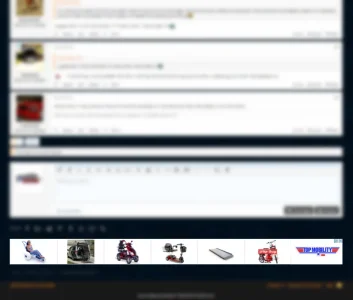

These are ads that display on the homepage, thread lists, and post pages:
I'm not seeing an ad on most pages. However, the fact that space is being allocated -- and I can see an iframe -- means that the ad code itself is loading and being processed by the browser. What is displayed in that location is then entirely down to the ad provider; the iframe is just not returning any content from when I looked. Unfortunately, we wouldn't have any direct control over that. I could really only recommend checking your ad code and if you're sure it's right, you may need to contact the ad provider. (I have certainly seen other XF2 installs with Google ads running, for example.)
Could be ad balance setting?
