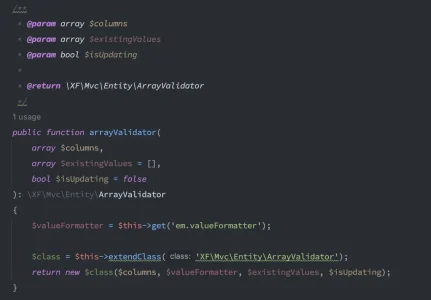

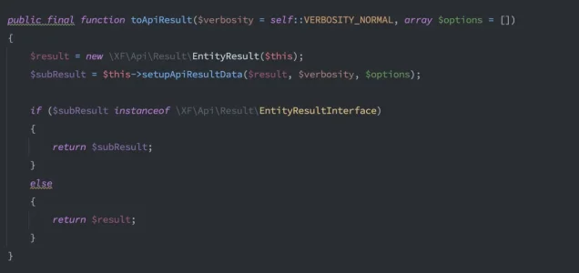

But, the code that I added to the method, is never called, nor are the breakpoints hit in debug mode when I set them. When I debug step per step, and the method "render" is called somewhere, then instead jumping into my extended class, xf is jumping into the original class (also, the parent class).
I'm really without ideas. I checked all generated output files, and they seem all fine. The extension_hint seems fine. Intellij recognizes and finds the new extended class. I deleted and added the class extension many times, just in case that helps, without success. I'm without ideas and I find it very strange because this is working correctly for a lot of other classes that I'm extending in the same way.
