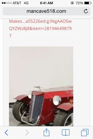

When I log in on my mobile device everything adjusts fine to the smaller screen except images.
They do not adjust to the small screen and just go out of the borders of the post with most of the picture getting cut off.
In full screen everything is fine across the board. Not sure what the issues is.

This is what happens with the image

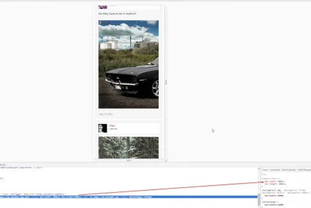

Loading for me at the moment. You have some inline styling setting max-width and max-height to 800px. Not sure where it is coming from but you can check the template bb_code_tag_attach to see if its been edited. Failing that, do as Brogan suggested and try it on a default style.
