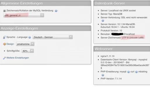

I add an feed for "Have you seen..?" and for "Announcements", but if i try to import HYS i got this error message.
XF\Db\Exception: MySQL query error [1366]: Incorrect string value: '\xF0\x9F\x99\x82\x0A\x0A...' for column 'message' at row 1 in src/XF/Db/AbstractStatement.php at line 212

I'm trying to confirm whether there's a bug here. If you did NOT have the fullUnicode option in config.php when you got that error, then it sounds like there could be a bug on our end.
However, if you had fullUnicode in config.php but had not run the conversion script, then this error would generally be expected when running into 4-byte UTF-8 content like this.
Sorry i hadn‘t explain.
It was an error because fullUnicode in config.php but not running the script. I did not read the manual till the end, i stopped after fullUnicode in config.php :LOL:
