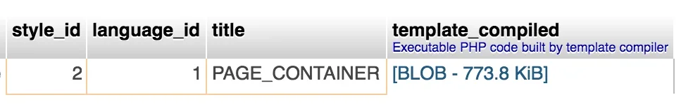

@Mike @Martok
Jake built a helper for the theme in a few places, so we're able to get this well under the 1mb default setting. So this should fix the issue for the future.
We'll post a patch shortly for those unable to change their max packet size.
