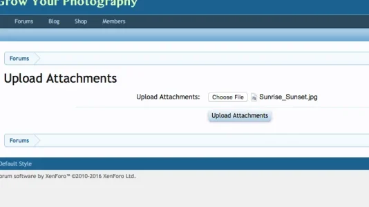

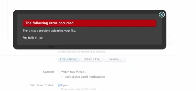

I'm getting an error message when trying to uploaded files my forum if the friendly URLs are enabled, but when I disable this feature, images upload perfectly fine using the flash uploader.
Probably something to do with the configuration of the rewrites? Any ideas of where to start.
