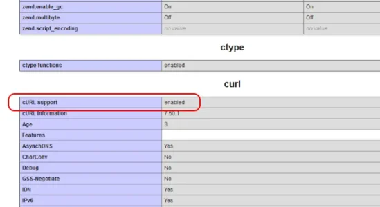

I will just add to this if you visit phpinfo (or create a small file to view it like this if you are not sure where it is in your web control panel) :
<?php
phpinfo();
Copy / paste that into a text file. Rename the text file to anything you like with a .php extension (loose the text extension, so its somename.php) and upload it to your web space, then visit it in your browser. Use your browsers search/find to look for "Curl" , hopefully you will see something like this or similar:
Please remember to remove the 'info' file you just uploaded when you have finished with it!
Then you will be able to see if it really is there / enabled or otherwise. (y)
