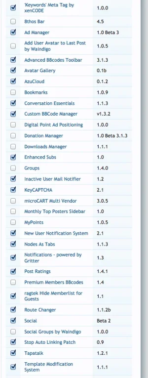

Whatsup with this? I havnt had any problems lately, the latest things ive installed was BB Code Manager and the paid version.
Also using KEY Captcha which has worked well for us for the past month.
Have you tried to go through and disable some of those required questions on sign-up?
I would possibly start by going through and disabling them for a bit then attempt to register.
That many custom fields it's more than likely an issue with one of them possibly

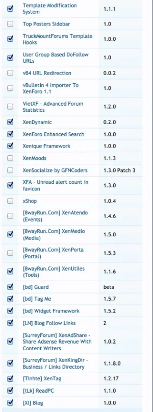

Hmmm, never seen it reported before but I guess you could try disabling new user notification system, looks to be the only real add-on that could be touching the registration process.
Any errors in the server logs?
